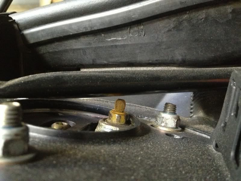

These are on my 135i.
I recently developed a gnarly rattle in the front driver's side top strut mount area. I popped the hood last night and saw this!:
Note that there is a gap between the adjuster and the top of the shaft. The top has been hitting the underside of the strut brace! :
This is my passenger side for reference:
I moved the strut brace out of the way and the adjuster still works well. I can push the adjuster down and the gap will close, but when I rock the car (load that that corner) it comes back up!!?? What is going on?
There is no fluid leaking anywhere and that corner dampens perfectly fine...
Huge thanks in advance for any advice, tips, solutions :)

Can you still turn the adjuster fully left and right. I had this happen on one of my (miata) koni's and the symptom was that I couldn't turn it soft. The price of a Koni yellow was so low that i just bough another one (ok, I know they sell them in pairs, but there's this place on Amazon that sells one at a time) rather than messing with a rebuild.

red5racing wrote:Can you still turn the adjuster fully left and right. I had this happen on one of my (miata) koni's and the symptom was that I couldn't turn it soft. The price of a Koni yellow was so low that i just bough another one (ok, I know they sell them in pairs, but there's this place on Amazon that sells one at a time) rather than messing with a rebuild.
Yeah, Adjusts all the way in both directions...

Had the same thing happened to a buddy of mine.You should to replace it.There should be a o-ring visible,soon there will be fluid leaking out.
