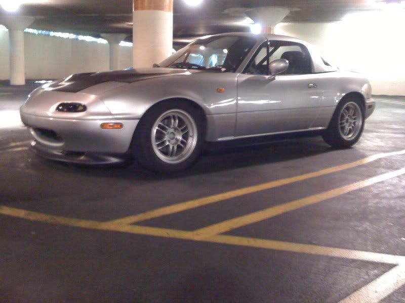

New rims, thanks roger!

Why did you decide to switch from 6ULs? or this is a daily-driver set?

how's the hood fitting right now? I'm going to socal soon and might pick one up as well.

The rpf1s will be my daily set while the 6uls track/autox/fun tires
The fitment isnt the best, but for the price it cant be beaten. It will fit very nicely with hood pins, something in the near future for my hood. Without the shipping costs it would be a sweet deal.
