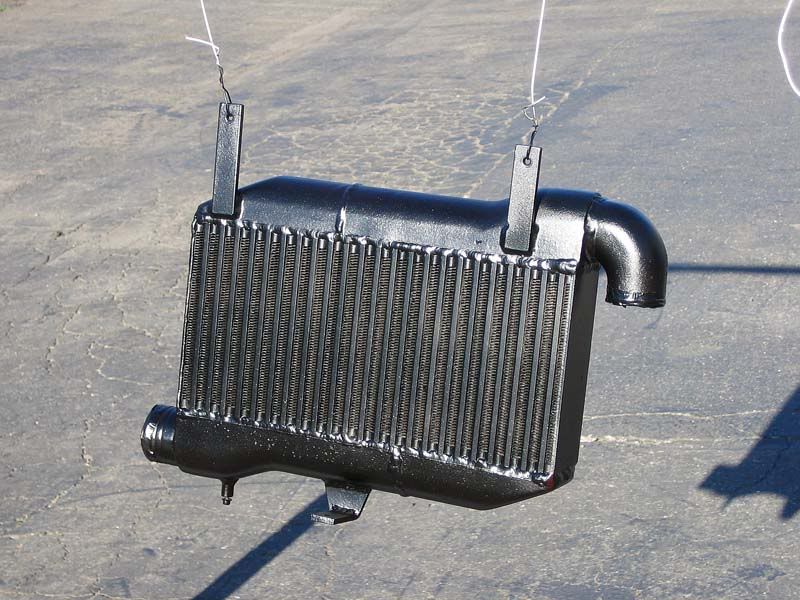

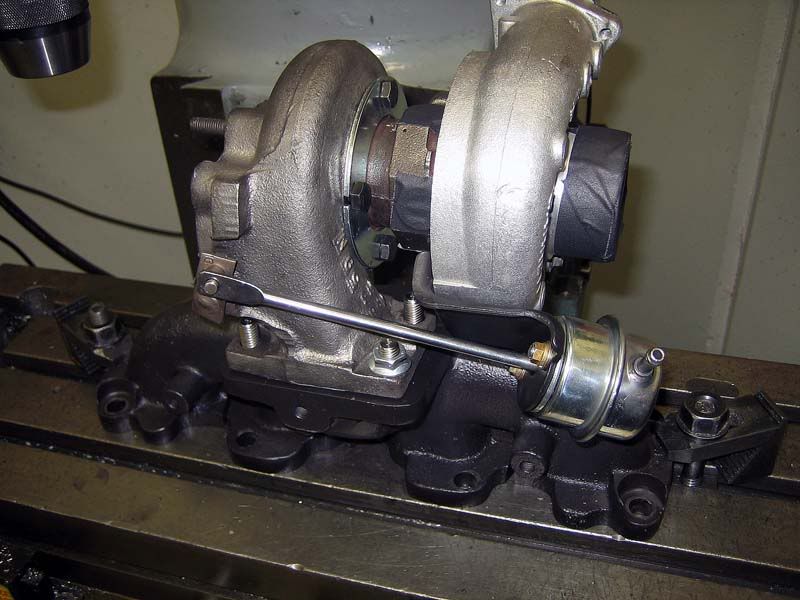

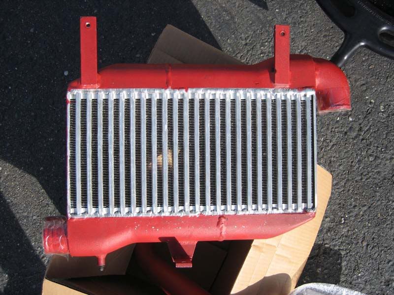

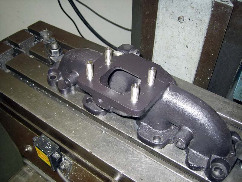

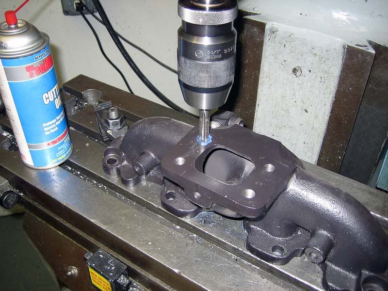

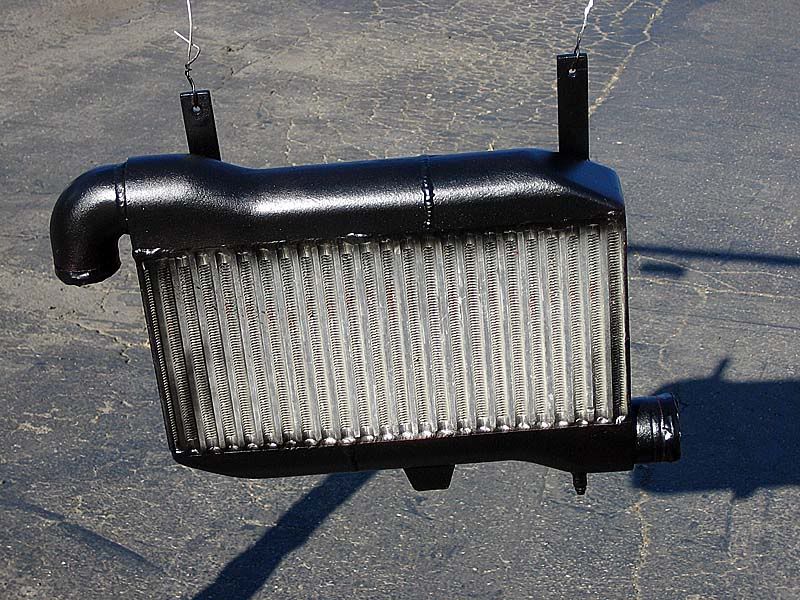

Despite working stupid hours and on weekends the last couple months I finally had a Saturday off (we're taking ~20 cars to Monterey Historics this year... enough the track is providing us with a huge tent). I managed to squeak in some work on turbo bits today... drilled/tapped the manifold for Andrews lovely 10mm Inconel stud kit, drilled the turbo to 10mm holes, and painted the intercooler for a bit more stealth.
Here's the pics...
Intercooler before and after...
Drilling/Tapping the manifold...
Studs in place...
Checking the fit of the turbo after drilling the mounting holes larger...

Postby orion4096 » Sun Aug 01, 2010 2:08 pm
You might want to check the lock and c-clip fitment on all of the nuts with the turbo on the manifold. I had to grind down the side of two of the locks to get them to fit with the older, smaller nuts. In the end I went with resbond and these 12mm socket sized nuts because I had to unbolt the turbo to remove the downpipe multiple times.
http://www.034motorsport.com/hardware-f ... 17611.html
Re: Bill - '97 STO
Postby rennkafer » Sun Aug 01, 2010 5:03 pm
orion4096 wrote:You might want to check the lock and c-clip fitment on all of the nuts with the turbo on the manifold. I had to grind down the side of two of the locks to get them to fit with the older, smaller nuts. In the end I went with resbond and these 12mm socket sized nuts because I had to unbolt the turbo to remove the downpipe multiple times.
I'll see how they fit with the stage 8 locking stuff... if it doesn't want to fit we have those nuts (like 034 sells) at work for use on the odd race car that has metric hardware.
