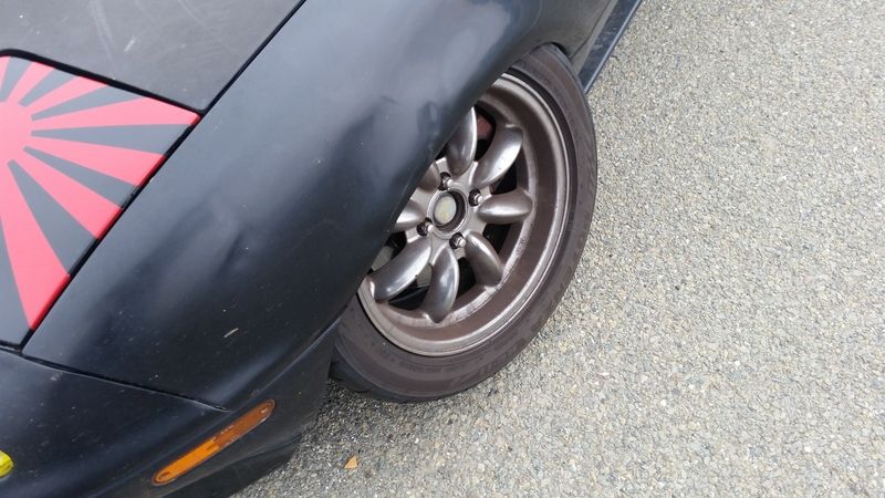

Heading up the 237 at 6:30 in the am at about 70ish I hear a pop, followed by some light wobbling. First thought, "Oh crap a blow out!" Then the wobble went to large thud as the nose dove for the ground, and nasty metal grinding sounds with smoke just pouring out the left front corner of the car. I was able to make it to the shoulder, hop out and viola..... a broken lower ball joint. I called Sunnyvale towing...... $400 "you are in a hazardous area and you car is lowered." I told them to pound sand. Called Campbell's Towing, He stared at the car for a good ten minutes..... $60 to tow it to my work. Deal!!! I was completely expecting the guy to rip the front of the car off..... I was prepared for it. He busted out a small jack, stuck some blocks of wood under the busted wheel, and slid the car up on the roll back. Kinda did the same at work, and not a single bit of damage to the nose or spoiler. I gave him a $100 just for not effing up the poor car then it already is LOL.
So the down and dirty. Called Fly'n and ordered up lower ball joints, HD sway bar mounts, and their stiffer rubber bushing kit. Got a hold of V8 Roadster and ordered up their rebuildable upper ball joint kit. $1000 in parts and this car should have a tight front and rear suspension once again.

I was able to get the car in the air Thursday and pull the left front wheel off. I was really concerned that I may have to replace the wheel, but I got lucky, it did not grind that much into the wheel. Maybe it is time for 6ULs? Everything else seems to be ok. With any luck at all I will get my car back on Thursday of next week. Although commuting on the GSXR is faster...... I have already had one close call from a lady texting while driving.

on the plus side. Her truck is now fixed. And my car is in our shop getting the bushing pressed in. Concealed damages! When the A arm popped it must have bounced off the rotor because there is a chunk missing from the rotor :(

Upper ball joints came in today. I am impressed with them! Got em from Bill at Miata Roadster. With any luck I will have my car back on the road by Friday. Stuck the damaged wheel on the balancer at lunch time, and it spins true and in balance :D
